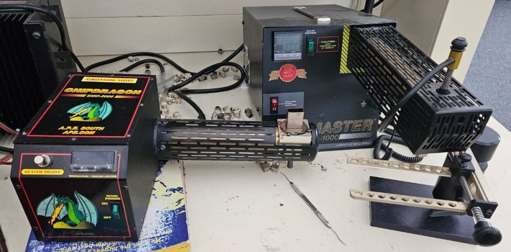

Luckily, with the warranty period ending, and the fact that we have Chip Dragon (I miss labeled the picture as Air Dragon though) stations spread across the country, we can do this.
In fact, Motorola XTS series radios as they age also have this problem.....but it only manifests after 10-15 years of use. And why we still use XTS series handhelds, we can repair them, they work well, and Battery Universe sells IS rated batteries for them, even though Motorola ended support and manufacture a few years back now.
Soldering is a skill that I wish more "radio" technicians were taught. Now, it is IT types being handed a radio system, that in some cases do not even know how to change a car tire (if their car even comes with a spare now), let alone solder.
