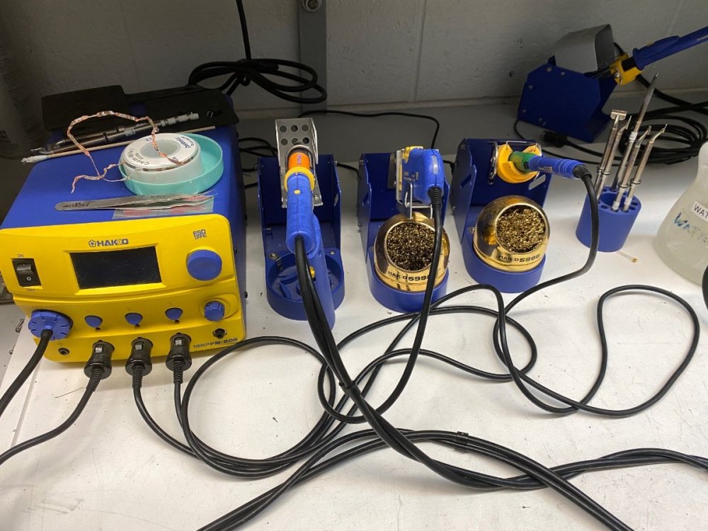

Luckily, with the warranty period ending, and the fact that we have Chip Dragon (I miss labeled the picture as Air Dragon though) stations spread across the country, we can do this.
In fact, Motorola XTS series radios as they age also have this problem.....but it only manifests after 10-15 years of use. And why we still use XTS series handhelds, we can repair them, they work well, and Battery Universe sells IS rated batteries for them, even though Motorola ended support and manufacture a few years back now.
Soldering is a skill that I wish more "radio" technicians were taught. Now, it is IT types being handed a radio system, that in some cases do not even know how to change a car tire (if their car even comes with a spare now), let alone solder.
Then, crappy solder that does not last, or flow well because it is hazardous....that gets to be a crazy situation for a large company and anyone that even tries to solder. I had an intern in a safety class mention that "soldering" should require a specific hazmat class and safety classes as you could get burned and contaminated with lead. I told my "leadership" that if they push too hard on that route, they may see some of the older techs leave...with no replacement. The youngest member of my team came from Icom America and is almost 40 now....and he can solder (but most often is working on Kenwood NX-51xx/53xx series radios, yes those fail too).
