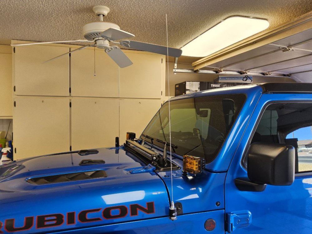

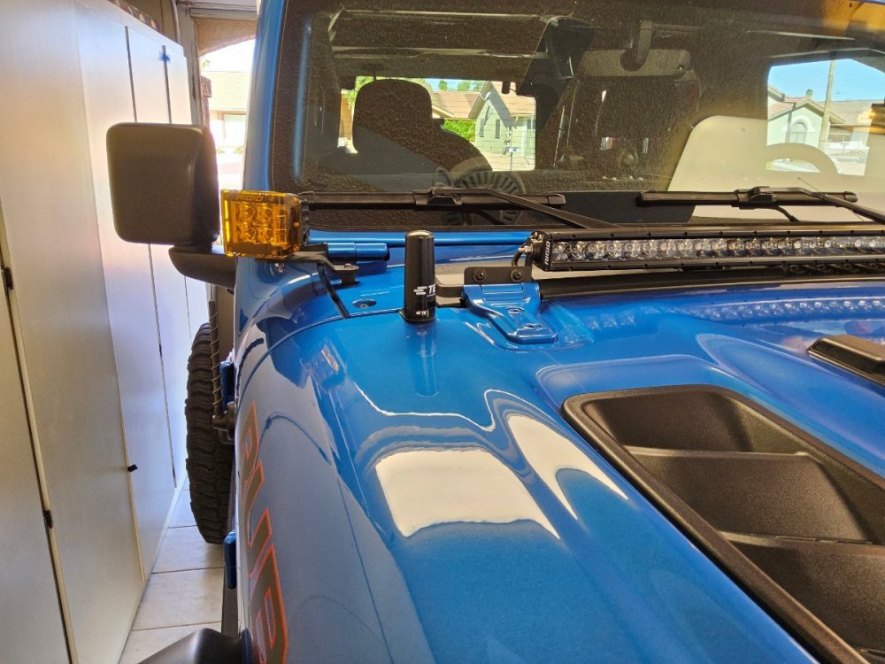

0 nokones Posted May 16, 2025 Posted May 16, 2025 I live approx. 25 miles northwest of Phoenix in "Old People Country" a.k.a. "Limber Dick Acres" where every time your hear a siren there is going to be a future Golf Car For Sale on the near corner and an Estate Sale, which is near a gazillion Jeep trails, and I am able to hit an analog wideband GMRS repeater approx. 80 air miles away that is southeast of Phoenix with a 40 watt XPR5550e on an analog narrowband channel using a Laird Phantom on my 23 Wrangler "IZARUBICON" 2 Dr. that is mounted on the hood just in front of the A Pillar/windshield. The radio does not have the wideband entitlement so I am regulated to just narrowband emissions for that radio which is not my primary GMRS and UHF radio. The radio is my primary DMR and Digital Channel radio. My primary GMRS and UHF radio is my XTL5000 Remote Mount. Also, I have a XTL2500 VHF remote mount with the base load 2 db omni antenna on a bracket on the side of the hood near the cowl/A Pillar and I am able to hit a low-level repeater on a four-story building approx 40 air miles away looking around the side of South Mountain. It appears that I fail way short for qualifying for the 200 mile club. I guess, I have more work cut out for me to make that happen and so I can hang with and shoot UHF skip for 200 miles away to anonymous "some people". Umm, maybe I don't. SteveShannon 1 Quote
