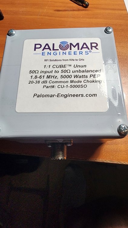

0 marcspaz Posted May 19, 2025 Posted May 19, 2025 1 hour ago, tcp2525 said: Keep the original balun on the antenna and put the 1:1 current balun right before it with a short jumper of good quality coax. Get a good balun rated for 5kw from DX Engineering. They are decent quality. Are you talking about a "Current Choke" very specifically or are you talking about a "Common Mode Choke"? Many people use Current Choke and Common Mode Choke interchangeably. These are 2 of the 3 Common Mode chokes that I own... I also have a 100w LDG Current Balun for when I am in the field without the amp (it's not handy for a photo). I think with the ACOM 1010, the Palomar would be the best choice. SteveShannon 1 Quote

0 tcp2525 Posted May 19, 2025 Posted May 19, 2025 7 hours ago, marcspaz said: Are you talking about a "Current Choke" very specifically or are you talking about a "Common Mode Choke"? Many people use Current Choke and Common Mode Choke interchangeably. These are 2 of the 3 Common Mode chokes that I own... I also have a 100w LDG Current Balun for when I am in the field without the amp (it's not handy for a photo). I think with the ACOM 1010, the Palomar would be the best choice. The one on the right is the exact one I'm using. Thanks for the photo as it helps a lot. Again, I put it real close to the original balun on the antenna. marcspaz and SteveShannon 2 Quote
