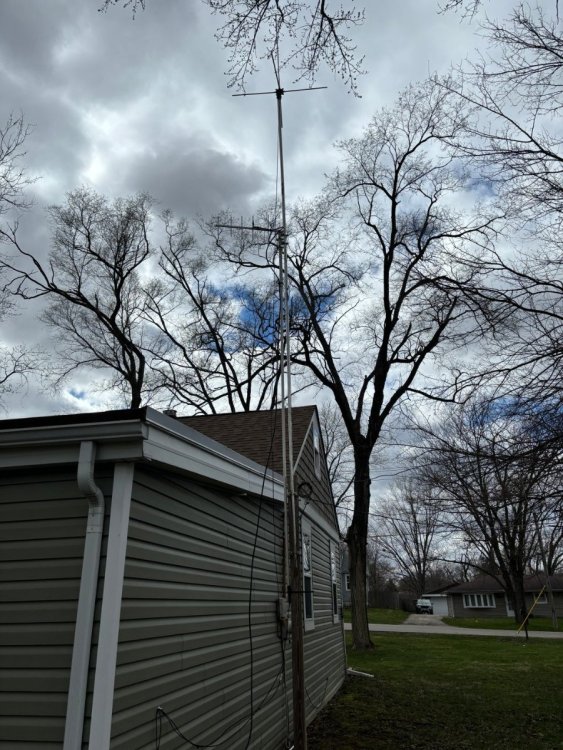

I put up a repeater because there are no gmrs repeaters in my area. Nearest is 80 miles south of me. I use it, neighbors use it, it's handy. If I'm within 20 miles of home and I call on my mobile I know for certain I will be heard.
