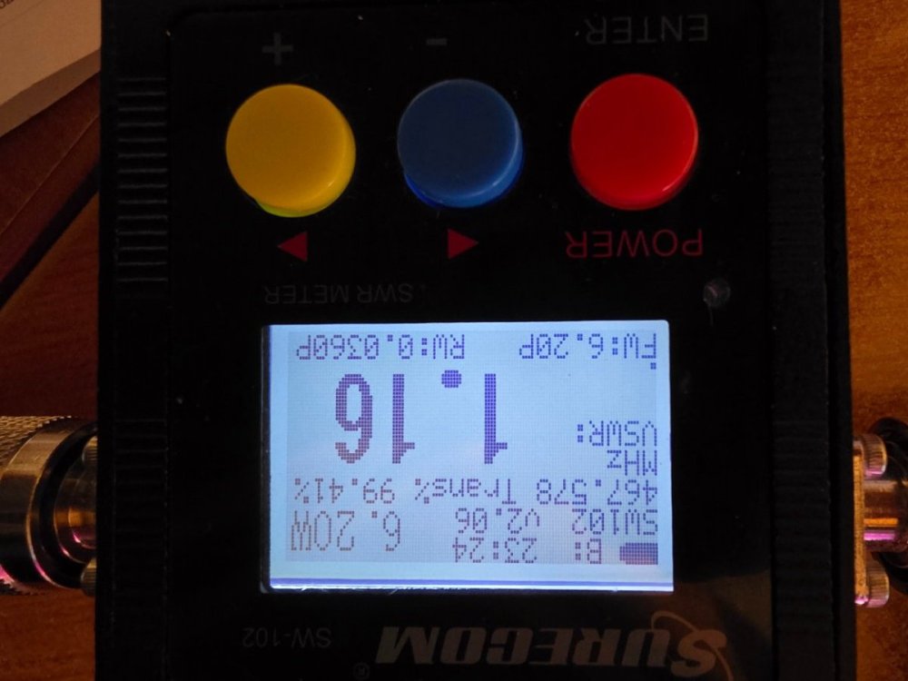

WRVB889 Posted July 21, 2023 Report Posted July 21, 2023 So I just tested the Betec 50v2 power and SWR with a Surecom SW-102 meter and 2' RG 8x patch cable and connected to LMR 400 to my j-pole antenna. Here are my results across several channels: Low Power 6.4 watts Medium Power 24.6 watts High Power 55.7 Watts My first test was with a 12' rg8x patch cable and the numbers were considerably lower (eg 38.4 watts high power) then I used a 2' patch cable and got the higher above numbers. WRUU653 and WSAM608 2 Quote
Lscott Posted July 22, 2023 Report Posted July 22, 2023 4 hours ago, WRVB889 said: My first test was with a 12' rg8x patch cable and the numbers were considerably lower (eg 38.4 watts high power) then I used a 2' patch cable and got the higher above numbers. You had your first practical experience with the losses in coax cable verses length. Some new radio users don’t have a good feel for it, or even know it exists. wayoverthere 1 Quote
