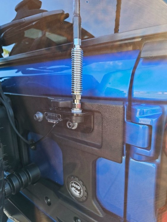

nokones Posted October 5, 2024 Report Posted October 5, 2024 3 minutes ago, AdmiralCochrane said: I think the critique was mostly regarding off-road rough trail driving. Mall crawling is a lot easier on antenna mounting. Did somebody say I was mall crawling? Nope that is not the case, but I know and I have first-hand experience of having an antenna ripped off and it wasn't because I was crawling at malls. There is a related discussion I posted somewhere on this forum I already lost my CB antenna on the trail. My CB Antenna did not have enough thread engagement with the antenna lug and coax cable stud and as we were climbing over the rocks in a creek wash a low-hanging tree branch ripped that sucker right off and I lost the lug, quick disconnect, spring, and the 5 Ft Firestik II antenna element. The problem was that the Heavy-Duty Spare Tire Carrier Bracket provided Antenna mount was a little too thick and I didn't have sufficient thread engagement between the coax cable antenna stud and the antenna lug so I abandoned that configuration and went back to the Terraflex Mounting Bracket bolted to the rear door hinge. The antenna lug and antenna coax cable stud have plenty of thread engagement now. And there's no doubt, I may/will lose more, but I have spare parts to fix/repair right away and get back on the air once I get home. Now, the problem is that Firestik no longer has the quick disconnect and heavy-duty springs. They blame it on Supply-chain issues and they are having difficulties in negotiating with various suppliers. I was able to find three quick disconnects and springs from a few sources throughout the country so at least I have spare parts. However, I'll be installing a Trunk-Lip/NMO Mount at the rear edge of my hood on the passenger side and with a Laird C27 Base Load Whip Antenna (parts already on-hand) for my CB Radio in the very near future once I get my quarterly radio programming updates done on all my mobiles and portables, to see if this hood/cowl configuration performs better You can see the difference in the thickness of the two antenna bracket mounts. Quote

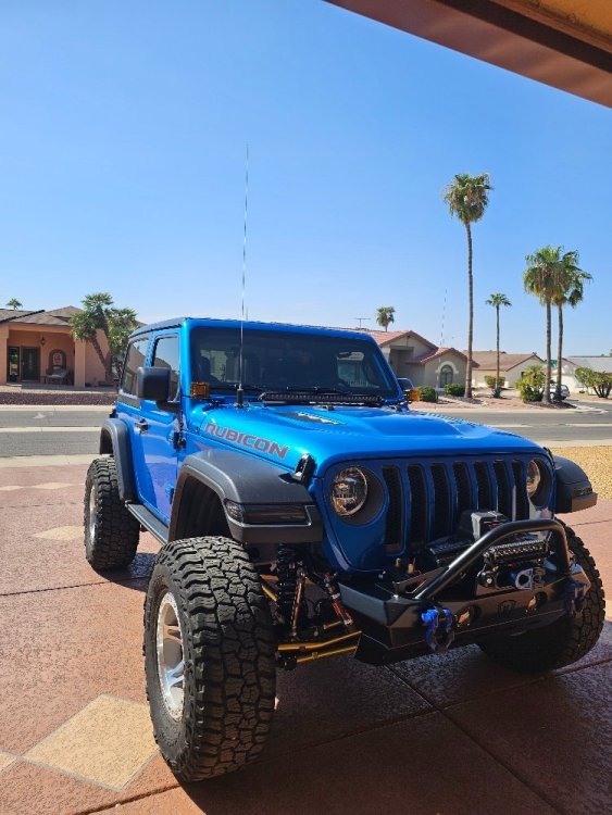

nokones Posted October 8, 2024 Report Posted October 8, 2024 Well, I got all my quarterly mobile and portable radio programming updates done so, my next project was to install the Antenna Specialist/Antenex/Laird/TE Connectivity Trunk Lip NMO Mount and C27 Base Load CB Antenna on my 23 Wrangler IZARUBICON 2 Dr. as recommended by a couple of forum members. The install went pretty easy and yes, I have chassis ground continuity at the mount and NMO connector. That was verified before I cut the cable to the desired length and installed the UHF (PL 259) Connector. The mount and antenna was installed at the hood rear lip edge in front of the cowl on the passenger side as near to the outside as possible to not interfere with my Ditch Light. Before I do any cutting of the antenna element, I better check the provided cutting chart and see what is recommended for the CB freqs and the chart indicated a cut at the 49" mark for 27 Megs. I measured the element and it was already 49". In checking the VSWR, right off the bat my Rig-Expert indicated an initial VSWR at just a tad less than 1.5:1 on Ch. 1 and a little less than 1.2:1 on Ch. 40. Since, I can't stretch the antenna element, I elected to raise the antenna element about a 1/4" in the antenna ferrel. That worked pretty good but, based on my readings, I elected to drop it a tad back down and I ended up with 1.05:1 across the board. I'll just have to live with that. Next will be the comparison test and see what would be the difference in the Farz between the Firestik II and the C27 antennae. However, I have to wait until my friend gets back from Colorado next week so we can use the same Avalanche vehicle and I need to get another C27 antenna, so we are testing with a like antennae again. Onto the next project. Oh, by the way, please note, there is no shine/glare on my tires, and it is obvious that there is definitely no armorall on my Mickey Bajas. It had to be the shine/glare from that well-polished Chrome Bumper. StogieVol, marcspaz and gortex2 3 Quote
SteveShannon Posted October 8, 2024 Report Posted October 8, 2024 51 minutes ago, nokones said: I ended up with 1.05:1 across the board. I'll just have to live with that. Drats! marcspaz and StogieVol 1 1 Quote

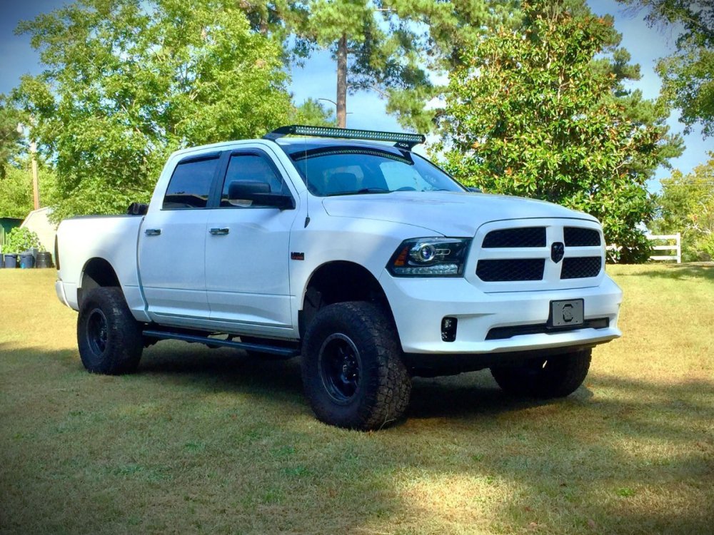

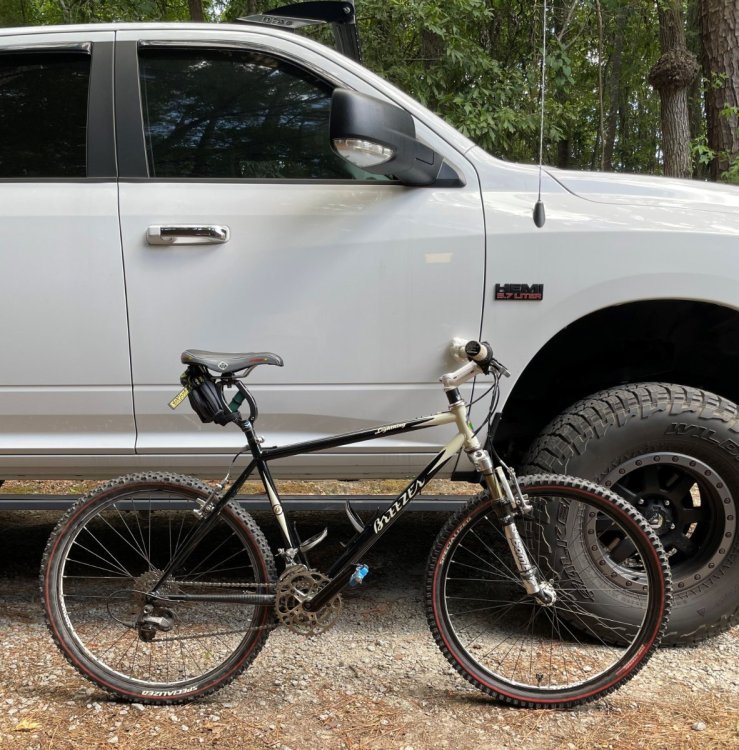

WSFA347 Posted October 16, 2024 Report Posted October 16, 2024 My off-road rigs StogieVol, SteveShannon and TrikeRadio 2 1 Quote

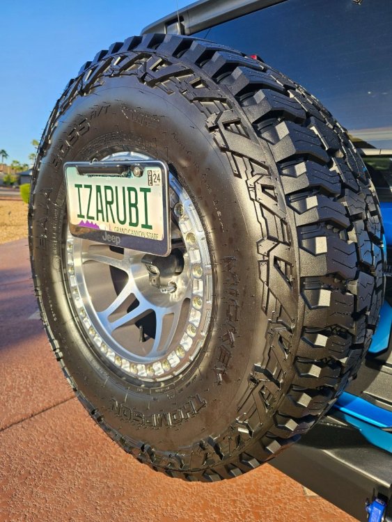

nokones Posted October 17, 2024 Report Posted October 17, 2024 After being accused of amoralling my tires by our beloved Queen, and then I responded to that allegation saying it was the glare off his freshly polished front chrome bumper on his "Notarubicon". Today, I took my Jeep for it's annual ceramic treatment and to have the Arizona Pinstripes buffed out and of course they a fantastic job as usual. Unfortunately, and after I specified, "No Armorall" treatment on the tires so I don't get ridiculed and lose all respect by not only our beloved Queen, also by my fellow Jeep Creep Friends. They even armoralled the Spare Tire and the damn steps of my rock sliders. Now it is very slippery climbing into the vehicle. I hope I can gain some respect back. StogieVol, SteveShannon and marcspaz 2 1 Quote
