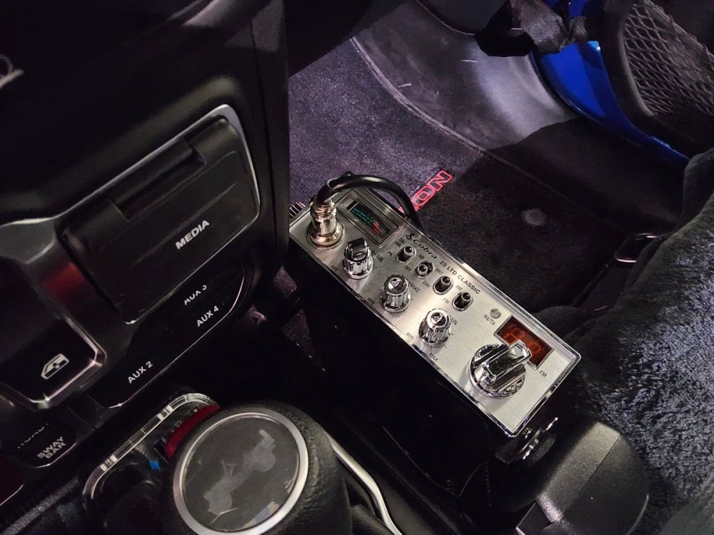

nokones Posted September 28, 2024 Report Posted September 28, 2024 11 hours ago, AdmiralCochrane said: Marc, I am going to get an FM CB sometime in the next year or two, but haven't decided how or where to mount it in my Jeep. Pretty sure we are only an hour or so apart (depending on traffic). We can probably both hit some of the same repeaters that are between us. I actually haven't tried them in a while This is where I mounted my Cobra 25 LTD Classic AM/FM CB Radio in my 23 Wrangler Rubi 2 Dr. AdmiralCochrane, marcspaz, StogieVol and 1 other 4 Quote
marcspaz Posted September 28, 2024 Report Posted September 28, 2024 That is typically where I mount my full-body radios, too. The tricky part is the antenna. Many people make the mistake of using a 3/4 mount and the nylon washer is trash in days... maybe weeks. But if you install a UHF mount with a UHF to 3/4 adapter, you get an incredibly strong mount. From there, it's just a matter of grounding. AdmiralCochrane 1 Quote

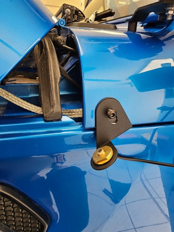

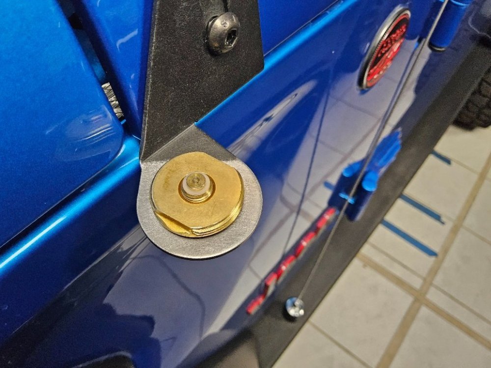

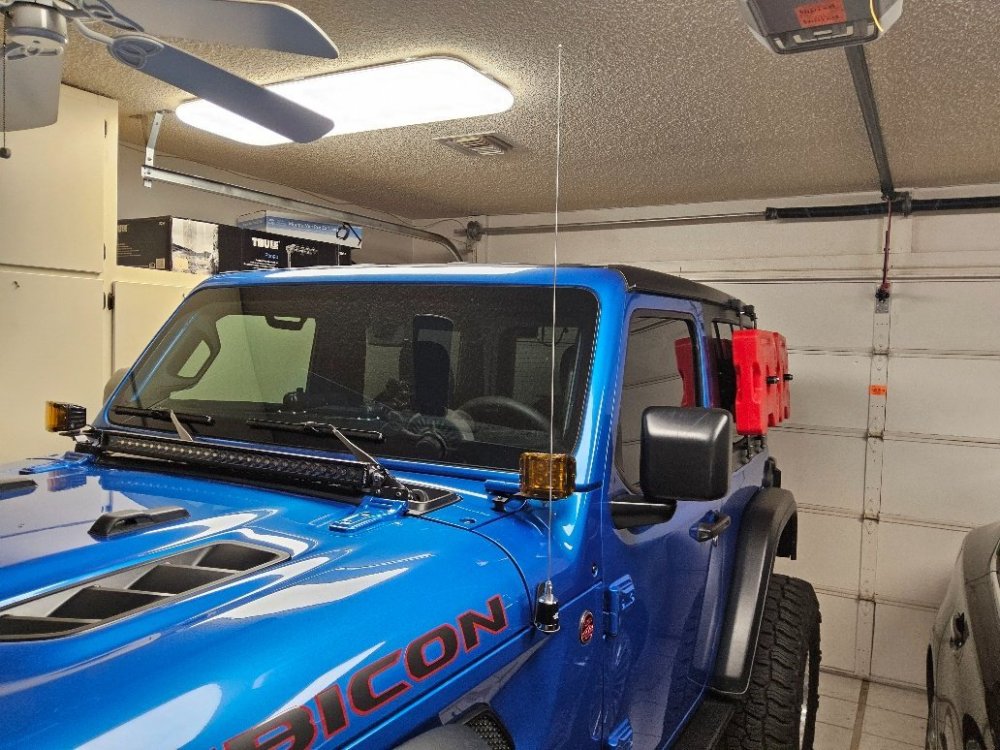

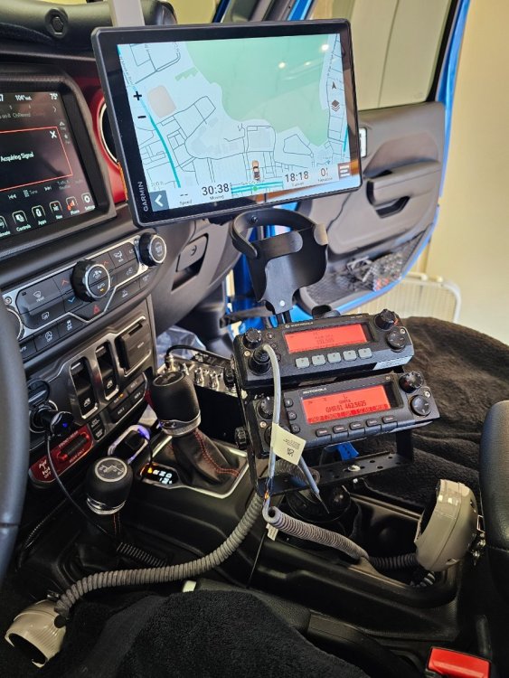

nokones Posted September 29, 2024 Report Posted September 29, 2024 I'm just finishing up with a third radio in my 23 Wrangler Rubi 2 Dr. to complement my Motorola XTL5000 High Powered Remote Mount UHF radio and my Cobra 25 LTD Classic AM/FM CB Radio. My third radio is a Motorola XTL2500 Remote Mount 840 Channel VHF radio. I 'm going to use a Laird TE Connectivity B1442 Base Load Non-Groundplane antenna hanging on the driver's side at the cowl with a Rugged Radio mount. I have the radio installed and the electrical connected however, I am waiting on a Powerwerx Anderson Power Pole Distribution Block. I had to remove my CB, Garmin Navigation Systems from the existing distribution block in order to power the newly installed radio. Essentially, all I have left to do, is finished up on the antenna mount grounding system, running the NMO antenna mount cable, install the Mini UHF connector on the cable, and tune the antenna. I intend to do that tomorrow. I called it a day at 3PM Arizona time. I've been out in the garage since 8AM and it was 113 degrees. Then, I will need to program the radio. StogieVol, AdmiralCochrane, gortex2 and 1 other 4 Quote
nokones Posted September 29, 2024 Report Posted September 29, 2024 6 minutes ago, marcspaz said: Very nice!!! Thank you. I just had to feed my addiction. I won't have many freqs program except for the Part 90 Business Radio Service freqs I'm licensed for, and the MURS channels for receive only since I can't get radio powered down to 2 watts so I can listen in my travels. The CPS will only allow me to take it to 10 watts. StogieVol, Lscott and marcspaz 2 1 Quote

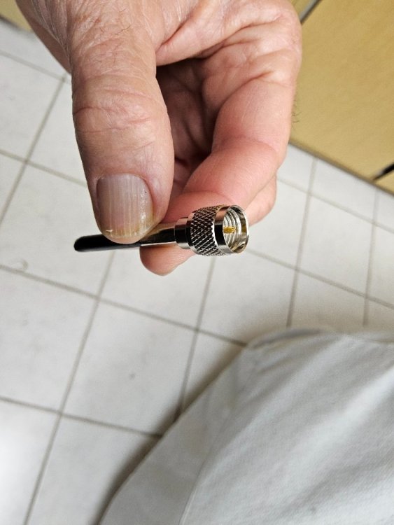

nokones Posted September 30, 2024 Report Posted September 30, 2024 Well, tuning my Laird/ TE Connectively B1442 Non-Groundplane antenna was very eventful and educational and I wasted a perfect and my last spare mini-UHF connector for nothing. I guess I got sorta impatient and less-than-confident with myself regarding installing the connector on the antenna coax. My VSWR reading was buried in the infinity zone and my 50-watt radio was measured with 10 watts forward with a bunch of reflected power according to my recently calibrated Bird 43 meter and slug. Humm, I may have a short or open circuit somewhere in the coax or at the mount. So, just be on the safe side, I get my Telewave In-Line RF Watt meter and check the readings again and they were the same. Also, I disconnected the antenna lead and connected a dummy load and I was transmitting 50 watts. So, thinking that I may have screwed up the installation of the mini-UHF connector on the coax, I decided to whack off the mini-UHF connector and install a PL 259 connector. The VSWR reading was no different than the mini-UHF connector at that point, I thought that I may have whacked off and wasted a perfectly installed mini-UHF connector unnecessarily. I decided to use a magmount to check the antenna and the VSWR was 8 or so but, I haven't cut the antenna yet. So, I cut the antenna based on the cut-chart for my targeted center resonance of 154 Megs which I whacked off 6 inches of the antenna element. The VSWR was 4+. Ok, at least the antenna is good and heading in the right direction and no doubt that the antenna element at full length was contributing to the infinity reading. So, I decided to start checking the antenna grounding system. My newly installed ground strap definitely had ground continuity to the mounting bolt, but not to the mounting bracket. I removed the bracket and wire-wheeled the paint off the bracket and reinstalled the bracket, and I had ground continuity at the bracket for the antenna coax mount to make a bonded ground. I reinstalled the antenna and mounting bracket to the vehicle, and I decided to start tuning the antenna with a Rig-Expert AA-650 Antenna Analyzer. I got to 1.4:1 VSWR at 154 Megs by cutting off 4 more inches of the antenna element to make a total of 10 inches that were cut-off and 4 inches less than what the cut chart specified. I decided to check the forward and reflected power with the Bird and my readings were a tad 50+ forward and what I estimate something way less than a watt reflected and the needle movement came pretting close of representing a VSWR of 1.3:1. That made me very happy. Very valuable lesson learned and I have extra mini-UHF connectors on order, but, I'll leave the PL 259 on the cable. gortex2 1 Quote

nokones Posted October 4, 2024 Report Posted October 4, 2024 2 hours ago, WRXP381 said: Gotta ask why a ground strap. I haven’t used a ground strap since the cb days. Never once on an gmrs set up. Also gonna be the worst possible location to mount an antenna. Because they make a good ground and I have had this for centuries so I decided to use it. There was no ground at the antenna bracket except through the coax. With all the electronics and if the antenna mount isn't grounded you are subject to transmitting noise to other electrical components. This antenna was not GMRS or UHF. It is a VHF Highband 150 Meg antenna. WRUU653, gortex2 and SteveShannon 3 Quote

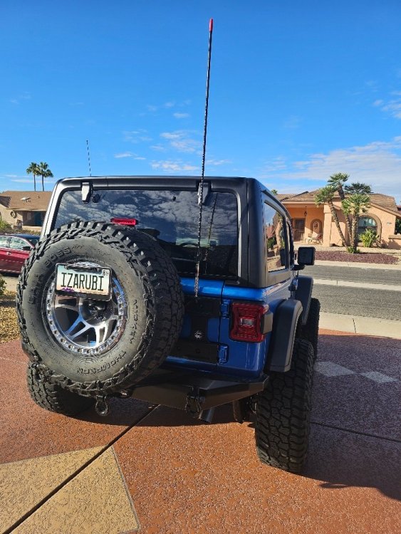

nokones Posted October 5, 2024 Report Posted October 5, 2024 17 hours ago, WRXP381 said: Also gonna be the worst possible location to mount an antenna. Is there a better location on a 23 Jeep Wrangler for a VHF Highband non-groundplane Laird B1442N antenna? There is no such thing as an adequate antenna mounting location on a Wrangler. These three locations are the best there is for a Wrangler and are being used for my Motorola XTL5000 UHF, Motorola XTL2500 VHF Highband, and my Cobra 25 LTD Classic AM/FM CB Radios. RayDiddio, StogieVol and SteveShannon 3 Quote
Guest Posted October 5, 2024 Report Posted October 5, 2024 Haha . The last one is the best option I’ve been jeeping for over 40years. I’ve built jeeps and off road trucks as a living for over 30years. I’ve installed 1000s of cbs gmrs and hams. The front fender in a line of sight frequency like 460 is the worst possible place to mount anytning. I see by the paint and over all appearance of your jeep this really isn’t a problem, but the fender mount is also the most susceptible to major damage. Any one I’ve ever off roaded with that had a fender mount anything has ripped it right off in the bushes. You have over spent big on the jeep and midland radio and lair antenna but then it gets neutered but being mounted in a place that it won’t work very well. When I off road I need my radios to transmit a good distance in all directions. Not just forward to the next jeep. Quote
nokones Posted October 5, 2024 Report Posted October 5, 2024 1 hour ago, WRXP381 said: Haha . The last one is the best option I’ve been jeeping for over 40years. I’ve built jeeps and off road trucks as a living for over 30years. I’ve installed 1000s of cbs gmrs and hams. The front fender in a line of sight frequency like 460 is the worst possible place to mount anytning. I see by the paint and over all appearance of your jeep this really isn’t a problem, but the fender mount is also the most susceptible to major damage. Any one I’ve ever off roaded with that had a fender mount anything has ripped it right off in the bushes. You have over spent big on the jeep and midland radio and lair antenna but then it gets neutered but being mounted in a place that it won’t work very well. When I off road I need my radios to transmit a good distance in all directions. Not just forward to the next jeep. My UHF antenna is on the rear glass and I have no problem hitting repeaters that I need to hit 40 or so miles away, and have communicated a good 15 miles simplex car-to-car. Also, I am able to hear FRS traffic approx 5 miles away. I can't complained about the performance of the glass-mount antenna, I am totally happy with it. The left-front fender mount is my VHF Highband antenna and is essentially will be simplex (151, 154, & 158 Freqs) car-to-car operations. I'm not a Amateur Radio Operator thus no 2M freqs programmed. The CB Antenna is self explanatory and I get about 2 1/2 miles AM and 3 1/4 miles FM. Oh by the way, there is no Midland radio in play in this vehicle. I need to have the ability of communicating on Part 90 UHF freqs. with both analog and P25 Digital emissions, so that means Motorola as noted. I also require the same emissions capabilities for the VHF Highband Motorola radio. Also, you did a great job negatively commenting on my antenna mounting locations and the fact I way over spent on my Jeep build but you never did provided/offer any expert opinion, if you even to happen to possess those expertises, on better antenna mounting locations for a 23 Wrangler. Did I over spend? Well, I really didn't care what I spent on the overall build. I went top notch stuff on everything and essentially replaced just about every suspension, steering, and driveline components at about 4,000 miles on the odometer, for reliability and to reduce the probability of a breakdown on the trail. I also didn't hold back from getting the required/essential top-notch trail recovery gear and equipment. Maybe I did spend more money then you or anyone else would have but, I don't deal or buy cheap inferior low grade POS junk. I only deal and buy quality products, stuff they would use in a public safety environment for the radio components, and as for the Jeep itself only race type quality components. I don't care if it cost more then what you would want to spend. I am totally happy with the total build and I immediately resolved and learned from the minor regrets of the early build stages. If you ever see any of my racecar builds, you will never see any corners cut or cheap POS inferior parts on them either. StogieVol 1 Quote
